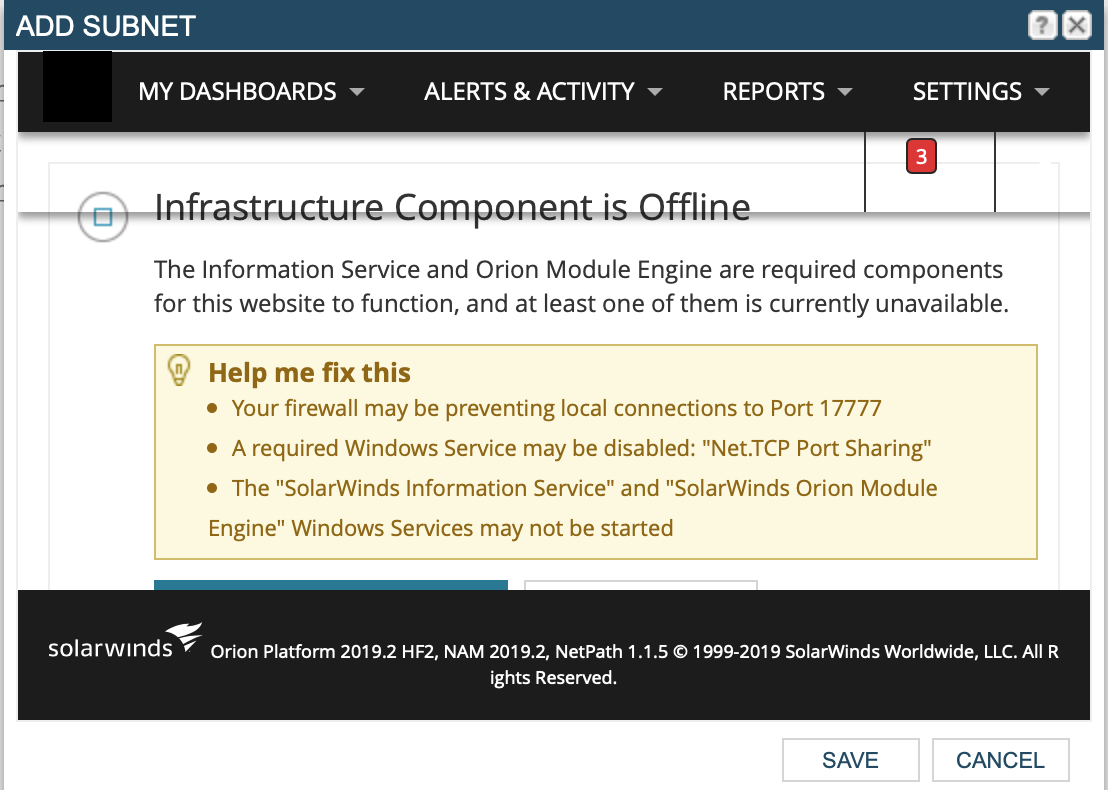

When attempting to browse to any IPAM views such as Manage Subnets and IP addresses, the following message appears,
Error Message:
Infrastructure Component is Offline
The Information Service and Orion Module Engine are required components for this website to function, and at least one of them is currently unavailable.
Sample Image:
IP Address Manager
  • Possible incomplete upgrade or installation done

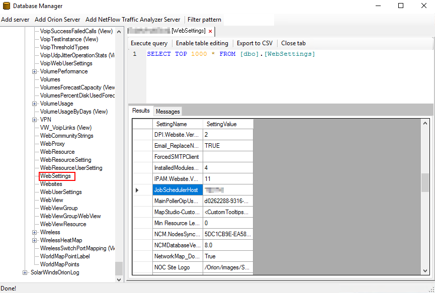

Ensure that JobSchedulerHost is pointing to the correct SolarWinds Server:
  1. On the Orion server, open Database Manager and select Add Orion Server to connect to the SolarWinds database.
  2. Go to the WebSettings table, double click the table, and Execute the query:
  3. Look for the setting name JobSchedulerHost and ensure that the value is pointing to the hostname of the main SolarWinds server. If it's assigned to a different poller, update it:
a. Click Enable table editing.
b. Double Click on the SettingValue of JobSchedulerHost and update to the hostname of the primary Orion server.
c. Press Enter to save the adjustment.
