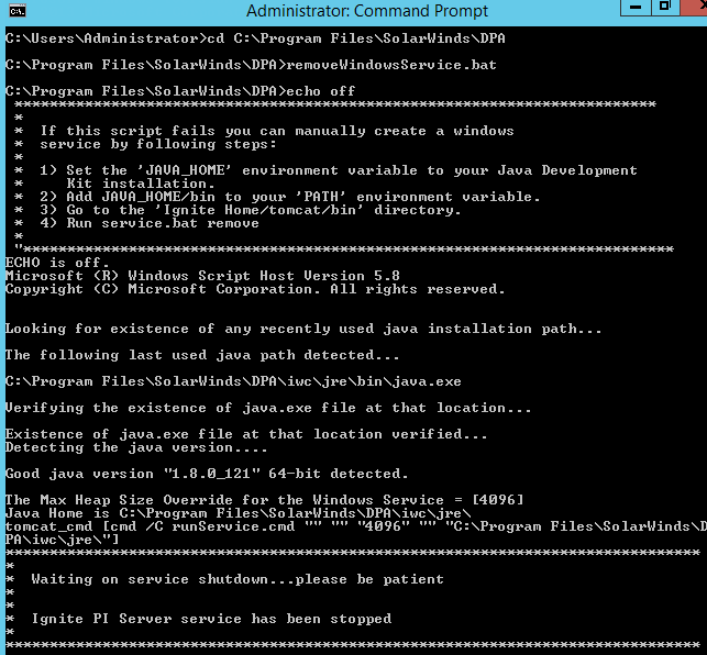

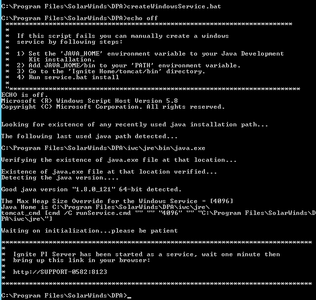

When the files are run in a command prompt, the following shows a successful change to 4096 MB max memory.
RemoveWindowsService.bat Output:
CreateWindowsService.bat Output:
