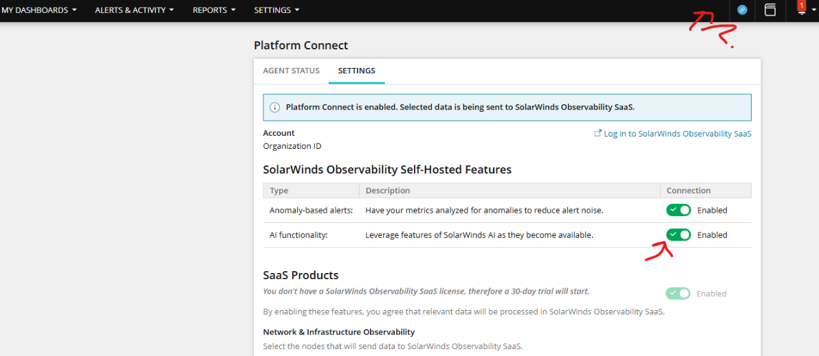

After upgrading OSH to 2026.1, Platform Connect is enabled but the AI Agent icon does not appear in the top menu of the web console.
The environment is connected to SolarWinds Observability SaaS, and the SaaS account shows an active AI license, but the OSH Platform does not reflect the entitlement and the SaaS license button is greyed out in Platform Connect.

The AI Agent button can be hidden for multiple reasons:
  1. Incorrect API token type used in Platform Connect
    • An ingestion token was entered instead of a valid API Access Token when configuring Platform Connect in OSH.
    • As a result, OSH connected to the SaaS tenant for data ingestion, but licensing and AI feature flags were not correctly synchronized.
    • The aiFunctionality setting was enabled (true), but the AI licensing feature flag swosh_swopilot_client was never populated in Orion.Licensing.Features, so the AI Agent remained hidden.
  2. AI feature prerequisites
    • For AI Agent to be visible and functional in OSH, both of the following must be true:
      • Licensing feature flag swosh_swopilot_client exists in Orion.Licensing.Features.
      • aiFunctionality = true in UamsClient.PlatformConnectInfo.
    • In OSH 2026.1, AI is only supported when the cloud provider is AWS; environments connected to Azure will not have AI functionality until cloud support changes.

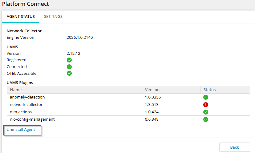

    Step 2: Reconfigure Platform Connect on OSH
    1. On the OSH Web, Go to  Console, Settings --> All Settings --> Add\Edit Platform Connector
      • Click on the "Uninstall Agent" button.
             2. In the OSH web console:
      • Launch the Platform Connect wizard.
      • When prompted for credentials, enter the new API Access Token from Step 1.
      • Complete the wizard to reconnect OSH to the SaaS tenant using the correct token.
    This forces OSH to re‑establish trust with the SaaS account using the correct token type, allowing AI entitlements and feature flags to sync.
