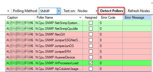

  3. Change the Polling Method to SNMP:
  4. From the leftmost column, select the target node to check the assigned/supported pollers for and select CPU from the next column:
  5. Click on Detect Pollers. Supported pollers are highlighted with a light green background and the currently assigned poller is shown with a bright green background and the box in the Assigned column is selected.
  6. Now select the N.Cpu.SNMP.CiscoGen1 or N.Cpu.SNMP.CiscoGen3 poller and click Add/Replace Poller.
  7. Click Yes.
