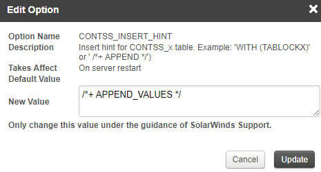

Task 2: Edit the DPA advanced option CONTSS_INSERT_HINT
In DPA:
- Go to Options > Administration > Advanced Options > System Options tab.
- Select Support Options.
- Click the CONTSS_INSERT_HINT option and enter the following value. Then click Update.
/*+ APPEND_VALUES */
