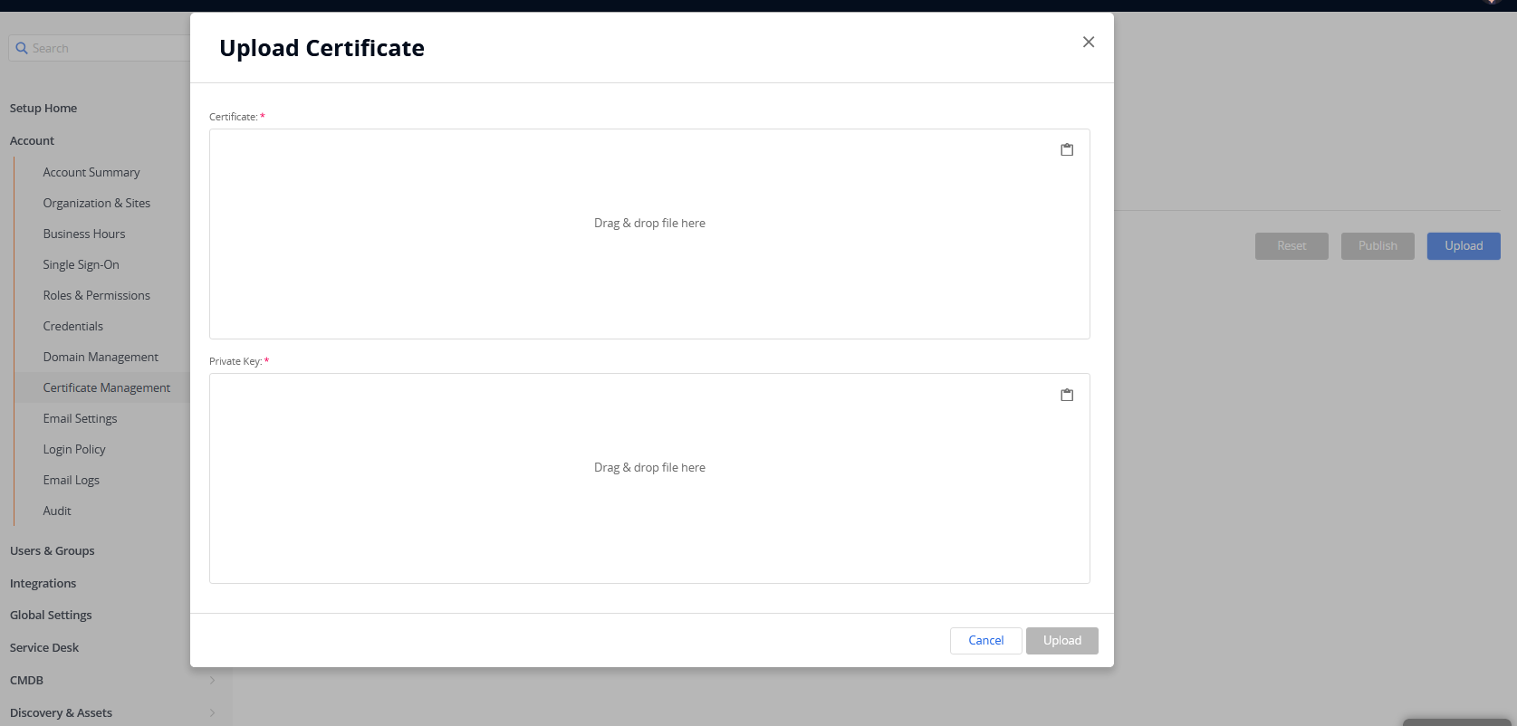

    • Go to Setup 🡪 Account 🡪 Certificate Management.
    • Click Upload.
    • Paste the Full Chain Certificate and Private Key into the appropriate fields.

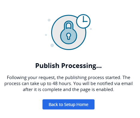

    • After the certificate and private key are uploaded, the status will show as Pending Upload.
    • Click Publish to complete the process.
    Note: After clicking Publish, a prompt will indicate that the certificate is being processed. This process can take up to 48 hours, and you will be notified once it is successfully completed.

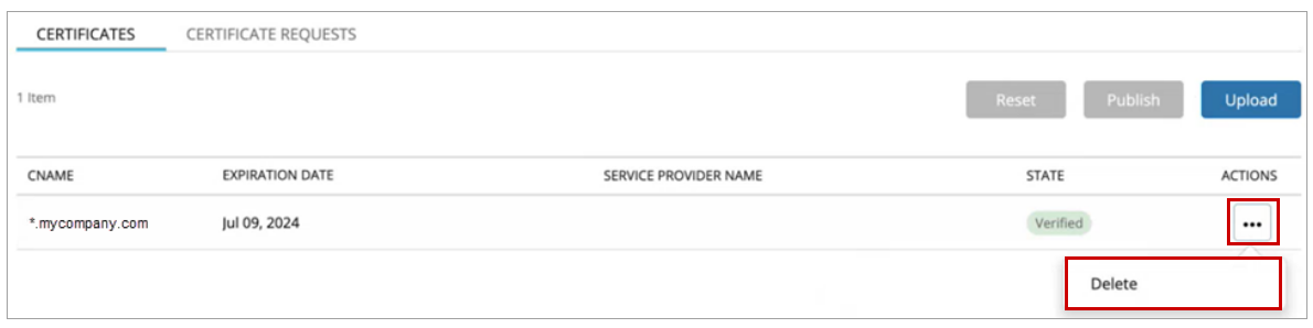

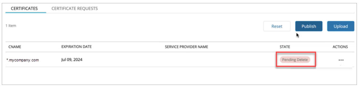

    • Hover over the Actions column and delete the existing certificate.
    • The status will change to Pending Delete. The current certificate will only be removed after the replacement certificate is successfully uploaded.
    • Click Upload.
    • Paste the Full Chain Certificate and the matching Private Key.

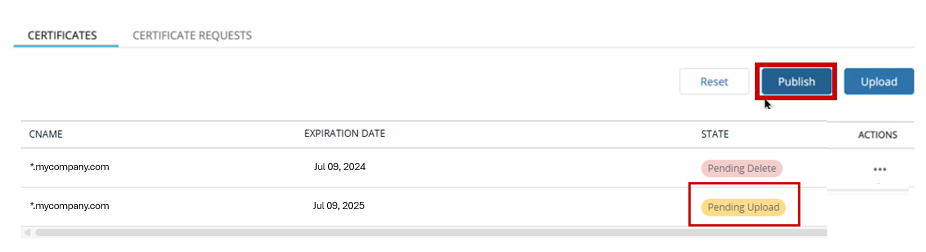

    • Confirm the new certificate shows as Pending Upload.
    • Click Publish to complete the renewal.
    Warning: If you are renewing the certificate, do not click Publish unless the replacement certificate has already been uploaded. Otherwise, the existing SSL certificate may be removed from SolarWinds Service Desk, and the site may go down.
