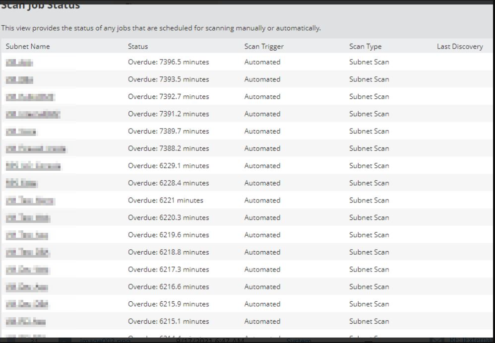

Checking the IPAM Settings > Subnet Scans > View scan job status seeing Subnets Status stuck in queue/overdue.

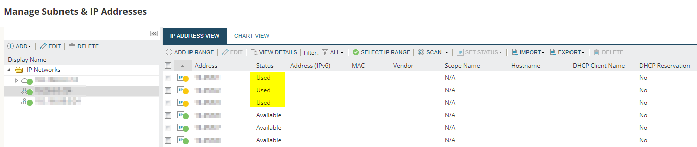

Checking the Manage Subnets & IP Addresses, there are IP addresses getting stuck on Used, Available, Reserved, or Transient Status.
