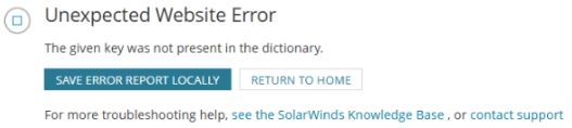

When editing a DHCP server, an Unexpected Website Error occurs. The details state "The given key was not present in the dictionary".

  • when editing DHCP server, an Unexpected Website Error occurs
  • When using the local web admin account, editing of DHCP server does not load

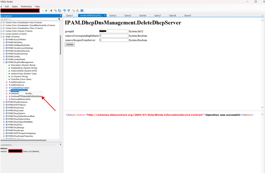

  1. Take note of the DHCP Server Group ID/s.
  2. Still in the SWQL Studio, expand IPAM > IPAMDhcpDnsManagement.
  3. Right-click on DeleteDhcpServer and select ‘Invoke…’
  1. In the groupId field, put the DHCP server group ID from the SWQL query above.
  2. Afterward, check if the edit DHCP dialog opens properly.
