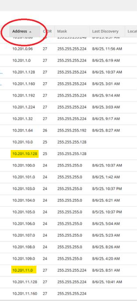

Sample Issue.
You can see that in the screenshot below, the subnet 10.201.11.0 should be next on 10.201.10.128, but the next one is 10.201.100.0.

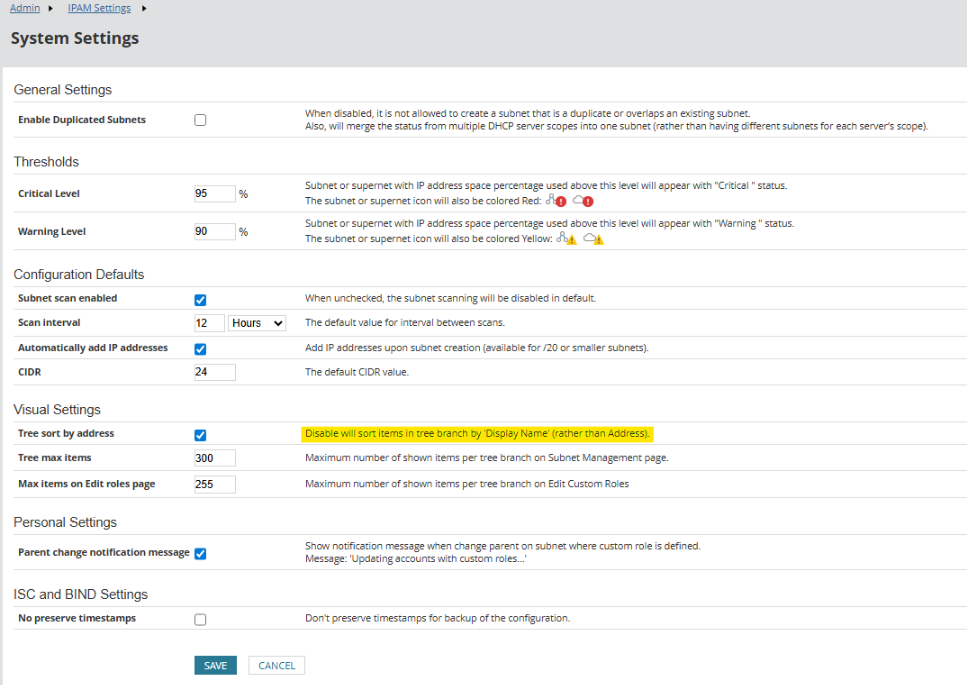

This setting is also enabled, and that's the indicator that it should be arranged by IP Address.

This has been identified as a known issue in IPAM 2025.2 through 2025.4.
This issue is fixed in IPAM 2025.4.1. Consider upgrading your environment.
