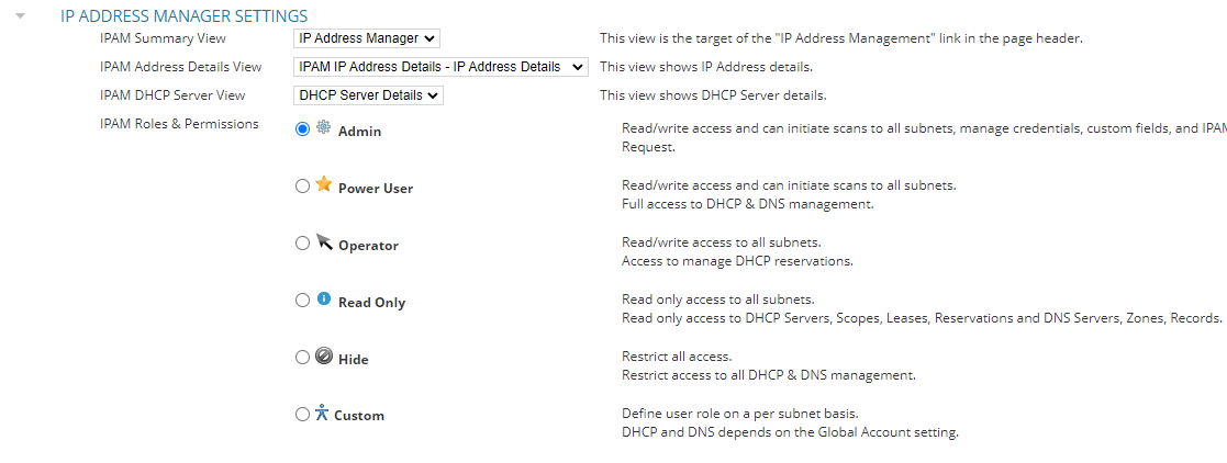

Users within an AD Group are not able to edit subnets and other IPAM data after updating the Role in the Web Console.

Users that are part of a Windows AD group may find that the IPAM Role has not been updated as expected. The value can be changed on the page at Settings > All Settings > Manage Accounts > Edit  Account:

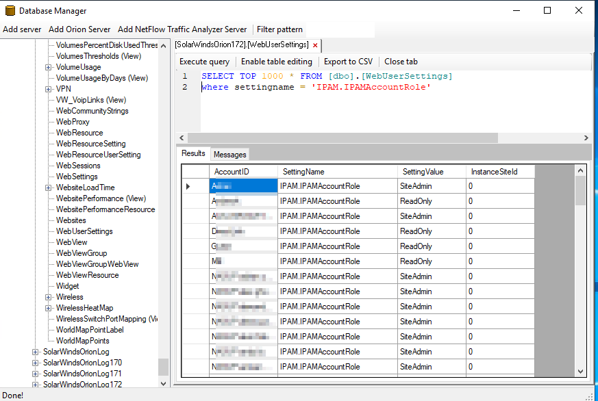

Changing the Role will update on the web console, but this change is not reflected on the WebUserSettings table.

Update the IPAM AccountRole value directly on the database:
  1. Connect to the Orion server.
  2. Open Database Manage in the SolarWinds Orion folder of the Start Menu.
  3. Select Add Orion Server and expand the SQL server and database in bold.
  4. Navigate to the WebUserSettings table and double-click.
  5. Execute the following query in the window on the right
SELECT TOP 1000 * FROM [dbo].[WebUserSettings]
WHERE SettingName = 'IPAM.IPAMAccountRole'
  1. Identify the account(s) in question and confirm the SettingValue. This should be SiteAdmin, PowerUser, Operator, ReadOnly, or NoAccess.
  1. If there are unexpected values, select Enable Table Editing.
  2. Edit the SettingValue column with the expected role and press enter.
  3. Execute the query again to confirm the change was committed to the database.
