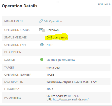

The following error occurs when creating an IP SLA HTTP:
DNS query error

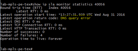

  1. Access the CLI, and then run the following command:
    •  show ip sla monitor stat <Operation Number>

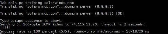

  1. Ping the URL used on the created IP SLA
When the router tries to ping solarwinds.com, it cannot translate that host. This is because the router is not configured to do domain lookup and it does not have DNS name server configured.

  1. Ping against that URL on the router.

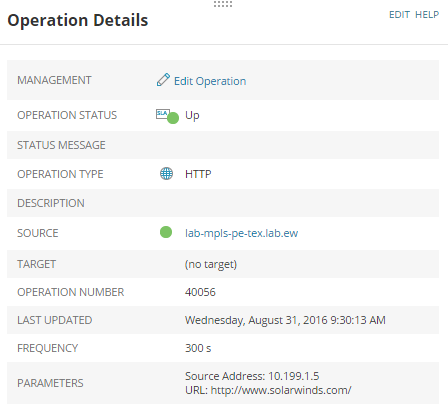

  1. Check the status on the VNQM. Operation should now be UP.
