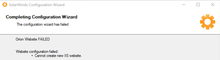

IIS failed to create website with the error: A specified logon session does not exist. It may already have been terminated
When you use the https protocol, the website unexpectedly crashes and stay inaccessible. The Configuration wizard cannot create the IIS website and dispalys the following error: Cannot create new IIS website. The error is also present in Configuration wizard logs or while assigning certificates in IIS: A specified logon session does not exist. It may already have been terminated.

When you use the HTTPS protocol, the website unexpectedly crashes and stays inaccessible. The Configuration Wizard cannot create the IIS website and displays the following error:
The ERROR seen in ConfigurationWizard.log (C:\ProgramData\SolarWinds\Logs\Orion):
Error 1: (pertains to https enabled in Config wizard but no SSL Cert selected both in IIS binding or in Config wizard)
ERROR Iis8Configurator - Unable to create Orion website: System.Runtime.InteropServices.COMException (0x80070520): A specified logon session does not exist. It may already have been terminated. (Exception from HRESULT: 0x80070520)
ERROR Iis8Configurator - Cannot create new IIS website.

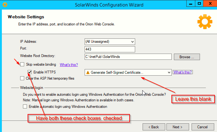

  3. Missing SSL cert in IIS but Enable HTTPS & Skip Website binding selected during Configuration Wizard
  4. If running into this error on 2022.x and newer, it could be due to configuration wizard parallelism.
Verify that you selected the correct options during Configuration wizard, the error is seen if you have below selection i.e Enable HTTPS, Skip Website binding is selected but no SSL cert is selected from drop down either due to missing cert or is not visible here.
- This is a known bug and it will be fixed in future release of Solarwinds Platform.
Workaround:
1. Add the https binding entry in IIS manager if it is missing and select a valid SSL certificate.
2. Manually create an entry in websites table in SolarwindsOrionDB via Database manager or SQL studio. Contact Solarwinds support to assist you with this.
3. Restart Solarwinds Netperfmon website.
