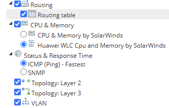

After upgrading to SolarWinds Platform 2024.4, 2025.1 and 2025.2, interfaces does not appear when running List Resources or discovery, although data such as CPU or Memory comes, network interfaces are not listed or do not appear properly.
Symptoms:
  • Interface discovery occurs, but no interfaces appear under List Resources
  • Interface discovery no longer works for some devices after upgrading to SolarWind Platform 2024.4, 2025.1 or 2025.2
