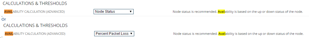

The Availability Calculation tab allows you to select one of two methods for determining device availability.
This can be Set on the Web Admin Settings page.
  • Web -> Settings -> Polling Settings

Method 2
                Bases the determination of node availability on a packet loss percentage.
SolarWinds Platform Web Console -> Settings -> Polling Settings ->
Availability Calculation (advanced)
Calculations & Thresholds
Availability Calculation (advanced) Node status is recommended. Availability is based on the up or down status of the node.
SWNetPerfMon-Settings-Availability Calculation
1 for Node Status.
2 for Percent Packet Loss.
