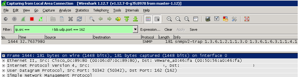

- In the Filter field, enter:
ip == AA.AAA.A.AA && udp.port ==162 where AA.AAA.A.AA represents the test node IP address. Or for any Target Node udp.port ==162
Sample Image
- All UDP traffic is now filtered between your server and the problem node.
