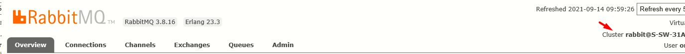

Consider a scenario where we have Primary main poller (31A) and Standby main poller (31B), 31A is the Active one and 31B is standby.
In this case, when you login to Rabbitmq management web console via openrabbitmqconsole.exe on both Server we should expect to see the cluster name at top right should always be pointed to the Active Server. In this example 31A
And whenever a successfully fail over happens to standby node, the cluster name will change to the Standby node in our case 31B in screenshot above

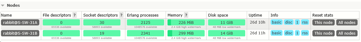

And node status should be green, i.e the name column below will be red if there is has a problem with any RabbitMQ node and the node can't join the cluster or cluster is broken. If a node is not healthy then refer to Troubleshooting RabbitMQ to fix and continue the validation part.
Note, the above screenshots is taken from Orion Platform 2020.2.4 environment, so the version of RabbitMQ and Erlang may be different if you have different version of Orion.
