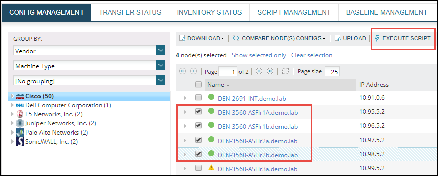

  1. Log in to the Orion Web Console.
  2. Click My Dashboards > Network Configuration > Configuration Management.
  3. Select the nodes and then click Execute Script.

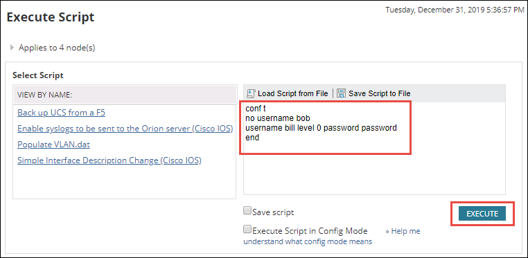

  4. To execute a previously saved script, click Load Script from File and select the file. Otherwise, type the commands.
  5. Click Execute.

Below is an example of removing a username from a Cisco IOS device and then an explanation of what NCM is actually doing.
conf t
no username bill
end
At the end of each line NCM is going to send a ${CRLF} to enter, so it looks like this:
conf t[ENTER]
no username bill[ENTER]
end[ENTER]
