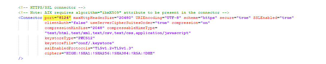

  2. Locate the Connector property below <!--HTTPS/SSL connector>, and note the port value. (By default, this is 8124.)

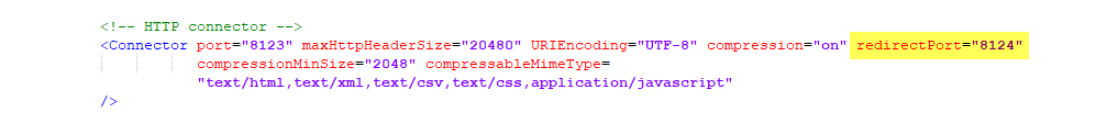

  3. Locate the Connector property below <!--HTTP connector>. Within the Connector property, add the following, where httpsPortNumber is the port value noted in the previous step:
    redirectPort="httpsPortNumber"
    For example:
    redirectPort="8124"
  4. If you make these changes after the upgrade, restart DPA for the changes to take effect.
