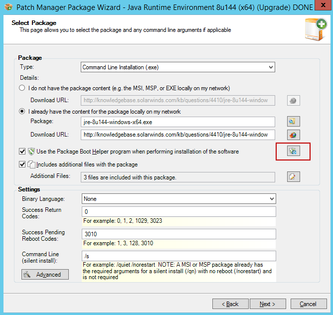

  4. Click Next twice in the Patch Manager Package Wizard window.
  5. In the Patch Manager Package Wizard, click the Package Boot Editor icon.

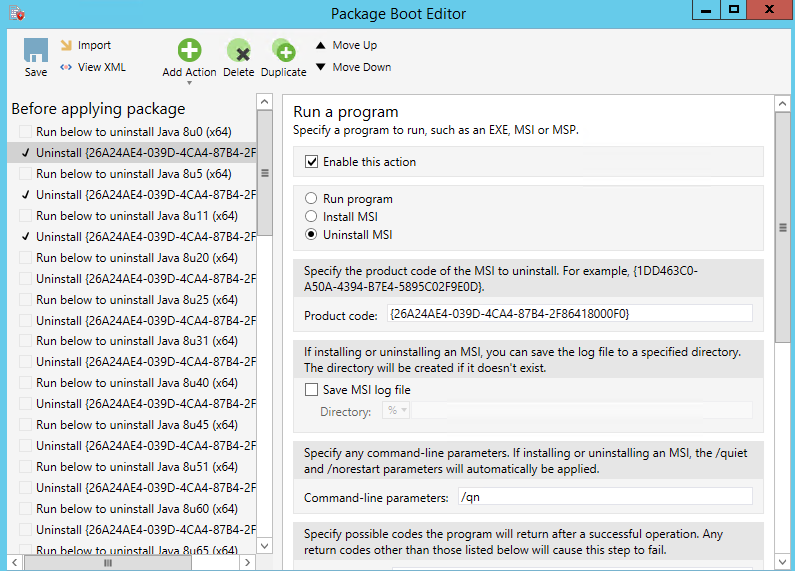

  6. In the Package Boot Editor window under Before applying package, select a package you want to uninstall.
    If you are running Patch Manager 2.1.5 and the package is not installed on the target systems, Patch Manager will ignore the selection and move to the next selected package.
    If you are running Patch Manager 2.1.4 or earlier, ensure that the selected Uninstall options are currently installed on the target systems. Otherwise, Patch Manager generates an error and the latest Java JRE upgrade will not be applied.
    Do not select a Run below option.
  7. Select the Enable this action checkbox to uninstall the package.
  8. Repeat step 6 and step 7 for each additional package you want to uninstall.
  9. Click Save.
  10. Close the Package Boot Editor window.
  11. Complete the Wizard.
