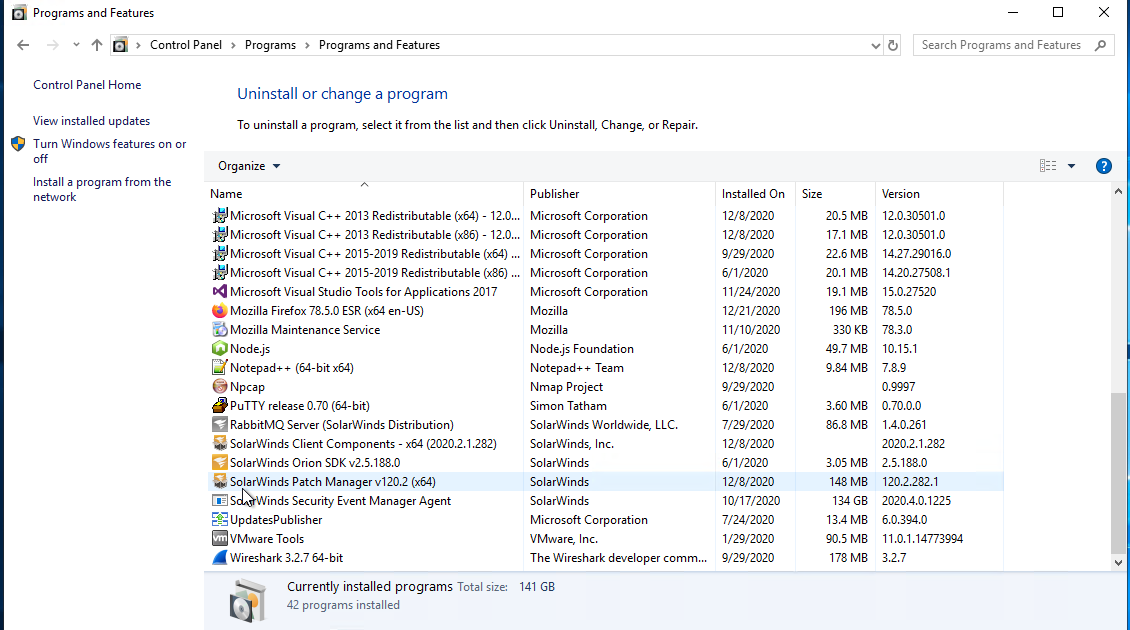

1. Open Control Panel>programs and features. Uninstall Solarwinds Patch Manager V.....
Uninstall SolarWinds Client Components.
