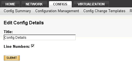

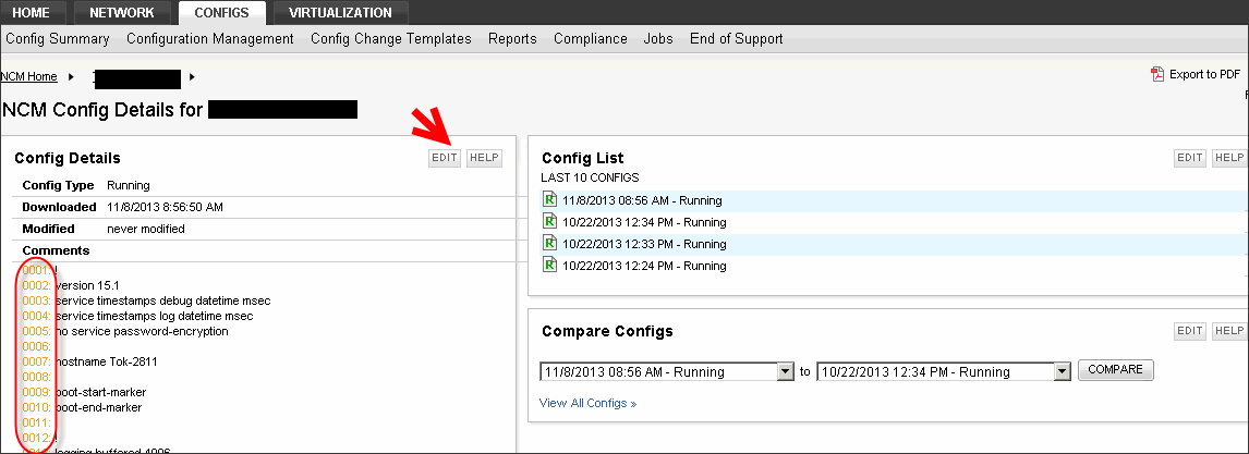

  3. To turn off the line numbers that are highlighted the following figure, click Edit.
  4. Deselect the Line Numbers option.
  5. Click Submit.
