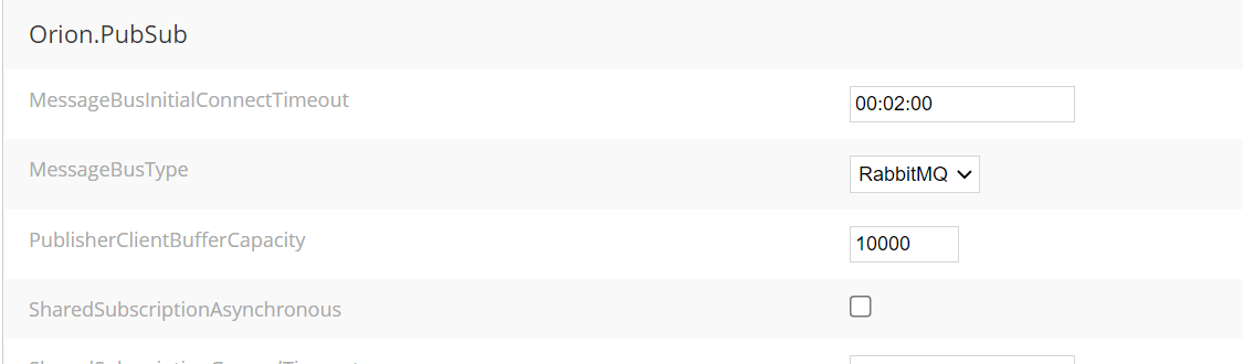

Method 1: Switch the message bus type via Advanced Configuration (Recommended)
  1. Navigate to the Advanced Configuration page on your SolarWinds Platform server:
    https://<hostname>/Orion/Admin/AdvancedConfiguration/Global.aspx
  2. Locate the centralized setting: Orion.PubSub.MessageBusType
  1. Change the setting value to RabbitMQ.
  2. Subscriptions automatically react to this change; however, the process has limitations. Wait a few minutes before continuing.
  3. Ensure that the InformationServiceV3 service is running on the Main Polling Engine (MPE) throughout this process.
  4. Run the Configuration Wizard on the Main Polling Engine.
Note: If you have a Main Polling Standby Engine installed with SolarWinds Message Bus as the selected message bus, you must also run the Configuration Wizard on the standby engine.
  1. If you experience issues on additional polling engines — such as data not synchronizing with the MPE website or other inconsistencies related to the Message Bus — navigate to each additional engine and restart the services.
