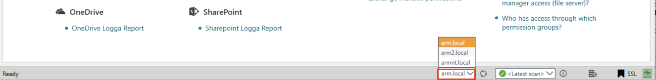

If there is more than one configured domain scan, you will be able to see only one at a time in the ARM Client software. To see the rest of the domain scans, you should use the drop-down menu to select the appropriate domain.
To select the domain that you want to load in the resource view, you will need to do the following:
  • Open the ARM Client Software
  • In the bottom right corner, you will see the currently selected domain
  • Click on the drop-down menu and switch to the domain that you want to load
  • Once the domain is selected, it will be loaded and ready to run reports or make changes to it
The screenshot below will help you locate the drop-down menu mentioned above.
