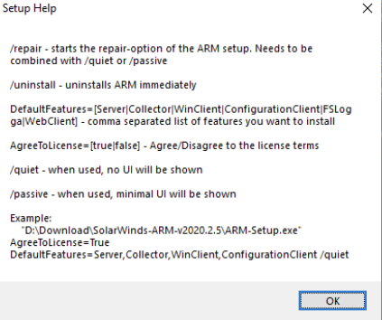

  3. Type in ARM-Setup.exe /h (This can vary from version to version. For example ARM Setup.exe /h or armsetup.exe /h).
  4. The command will show you possible parameters and examples that you can run:
  5. Using the help dialog from the screenshot above you run the silent installer per your needs.
