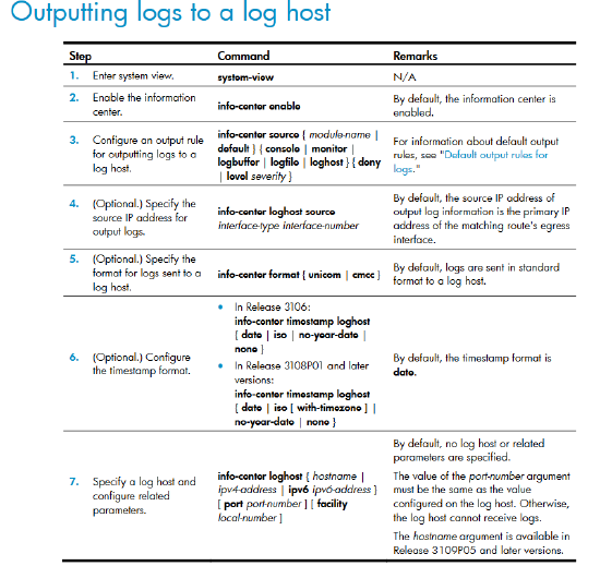

As stated in the following Manual: HP 5130 EI Switch Series  (© Copyright 2018 Hewlett Packard Enterprise Development LP, available at https://support.hpe.com/hpesc, obtained on Dec 27, 2018)  on page 58 (when searching in the PDF it's page 67 of 319) under the table Outputting logs to a log host.

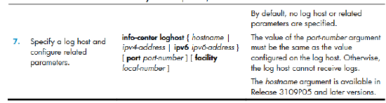

Step 7 explains the full command:
The command: info-center loghost <loghost-ip-addrees> facility local7
[A different local facility number can most likely be chosen. In this example local7 was used]
