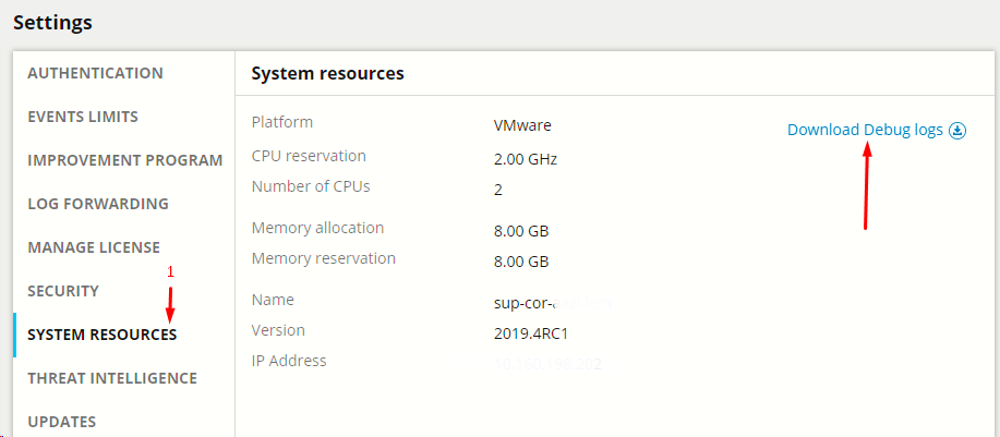

If you are running SEM versions 2019.4 and later, follow these steps:
  1. Visit https://your-sem-server/webui/settings to access the HTML5 console.
  2. On the Settings page, click the System Resources tab, and then click Download Debug logs.
  3. Wait for few minutes to be prompted with the debug logs (.tgz file) to download to your system.

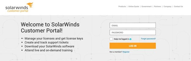

  1. Log in to the SolarWinds Customer Portal.

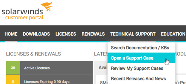

  2. Open a Support Case. You can do this one of two ways: 1) On the Customer Portal menu bar, navigate to Technical Support > Open a Support Case, or 2) Scroll to the bottom of the Home page and click Open a Support Case.

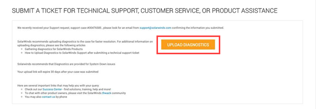

  3. After you submit a case, click Upload Diagnostics.
    Note: You have the option to upload your diagnostics as you create your support case, or you can upload your diagnostics up to 30 days later.

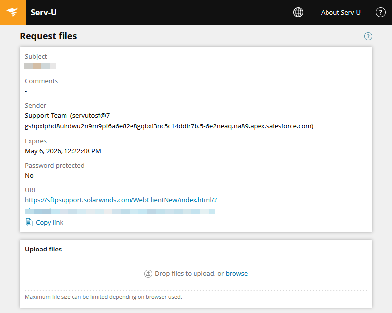

    The Serv-U File Sharing page appears with options to add files via drag-n-drop or browse.
  4. Drag-n- drop files, or click Browse to find and select your files, and then click Upload. After uploading your files, the case is updated, providing Support representatives with access to the diagnostic files.
