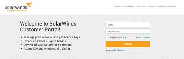

To upload your diagnostics, create a support case in the Customer Portal (if not done already).
  1. Log in to the SolarWinds Customer Portal.

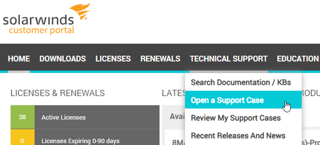

  2. Open a Support Case. You can do this one of two ways: 1) On the Customer Portal menu bar, navigate to Technical Support > Open a Support Case, or 2) Scroll to the bottom of the Home page and click Open a Support Case.

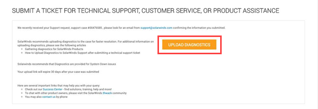

  3. After you submit a case, click Upload Diagnostics.
    Note: You have the option to upload your diagnostics as you create your support case, or you can upload your diagnostics up to 30 days later.

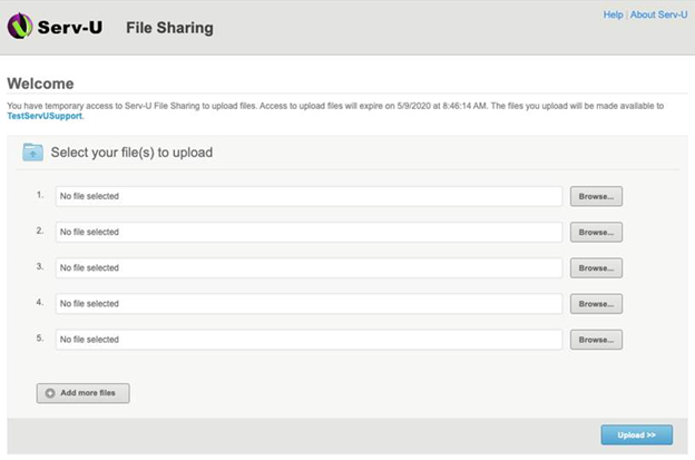

    The Serv-U File Sharing page appears with options to upload one or more files.
  4. To upload one or more files, click Browse to find and select your files, and then click Upload. After uploading your files, the case is updated providing Support representatives access to the diagnostic files.
