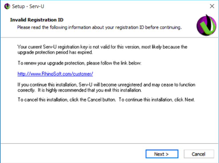

License related issues during or after upgrade:
If there is a message about an Invalid Registration ID while running the Serv-U installer, click NEXT and proceed with completing the upgrade.
