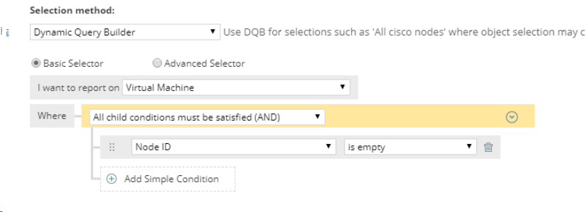

1. Create a Report to list all VM Guests that are not mapped to a SolarWinds Platform node object yet.
     a. From SolarWinds Platform web > Reports > Manage Report > New Report
     b Choose Report > Custom Table
     c. Use the following for the datasource

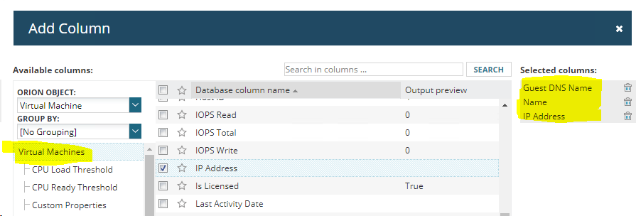

     d. Add GuestDNSName, Name and IP address columns
      e. Run the report choosing excel format so that you can easily grab the static IPs

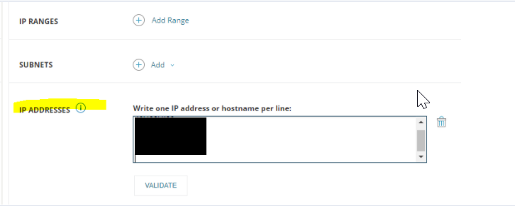

     a. From web console > Settings > Network Discovery > start
     b. choose the list IP address and paste the IPs from the report. ( I'd do it in small chucks not several hundreds in one go, maybe 50-100 per run)

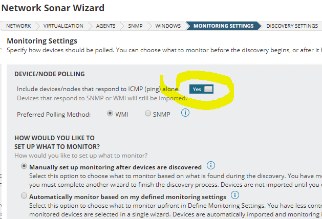

     c. If you only want to add them as ICMP nodes, just keep clicking next to bypass the other polling options. Once you are in the "Monitoring Settings" section turn on the "Include devices/nodes that respond to ICMP (ping) alone. "
option and complete the entire process and run the discovery.
