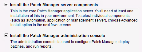

  1. In the Installation Type window, select the following, and then click Next:
    • Install the Patch manager server components
    • Install the Patch Manager administration console

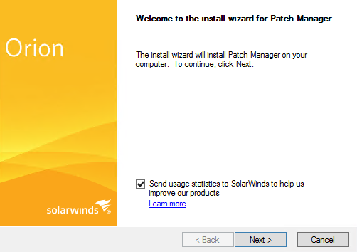

  2. Click Next on the Welcome window.

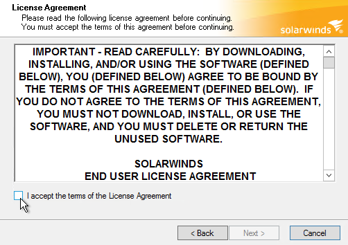

  3. If you accept the terms of the license agreement, click Next.

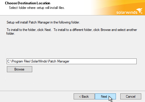

  4. Accept the default destination (recommended) or select another location, and then click Next.
    The wizard installs the Patch Manager software in the selected location.

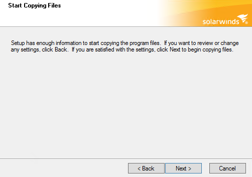

  6. Click Next to copy the program files to your system.
    After the setup completes, the SolarWinds Configuration wizard automatically runs.

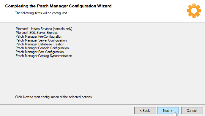

  15. In the Proxy Server Settings window, the installer checks your Internet connection.
    When the check is completed, the Completing the Patch Manager Configuration Window is displayed.
  16. Click Next.
    The Patch Manager Configuration Wizard completes the installation.
