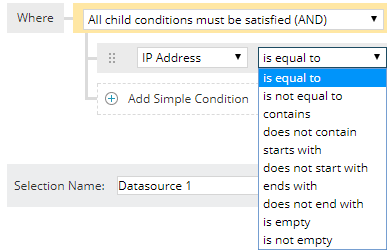

In the Dynamic Query Builder, you don't need to use any wildcards, just select the correct operator - starts with or ends with.

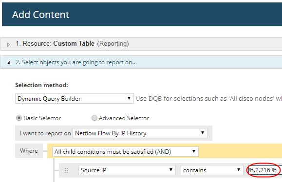

Examples

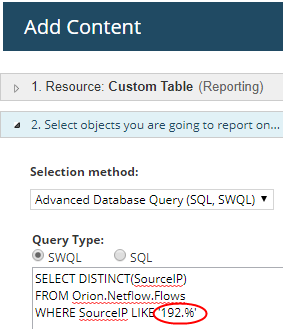

Advanced Database Query
