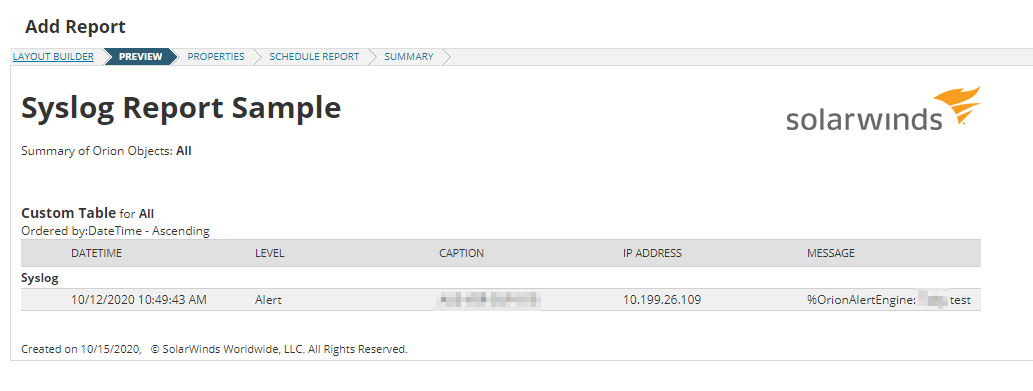

  • Then you can either export out the report as excel or schedule the report to be sent as a .csv, .pdf or html format.
  • Sample Output below:

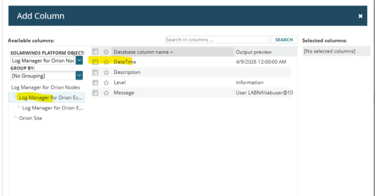

4. Add Columns > Add the necessary columns like Caption, IP address, message under Log Manager for Nodes object
5. Time-based settings can be set to Yes or No > Submit

Note : If you want to use date filters (last 7 days, Yesterday), tweak the report settings - instead of "created" use "datetime" as the date column filter:
