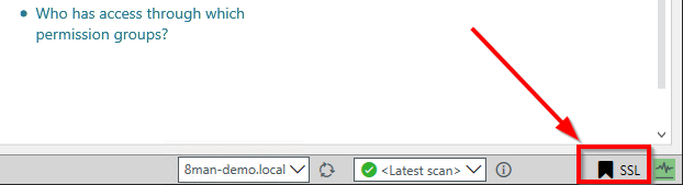

5. Launch ARM main or configuration application and enable SSL by clicking the gear icon on the login screen.

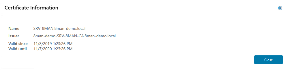

6. To validate SSL is working click on the SSL icon at the bottom right in ARM main or configuration application as shown:
Note: When you click on the SSL icon as shown in above image the cert info should be shown like this:
If you are running ARM 9.1 / 9.2 /2019.4 - this info may be blank due to a known issue. This issue will be fixed with version 2020.2.

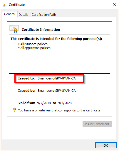

If using custom server certificate (optional section)
If you like to use a certificate with a different name other than the computer name of ARM server you must note the following:
<Network>
<ssl>
<certificate> CertificateName </certificate>
</ssl>
</Network>
