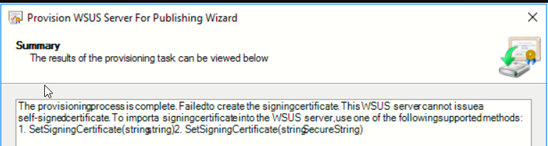

When you generate a software publishing certificate  in Patch Manager MMC console using the Server Publishing Setup Wizard, the procedure fails to create the self-signed certificate with following message in GUI
and we see following errors in log
Message in GUI
The provisioning process is complete. Failed to create the signing certificate. This WSUS server cannot issue a self-signed certificate. To import a signing certificate into the WSUS server, use one of the following supported methods: 1. SetSigningCertificate(string, string) 2. SetSigningCertificate(string, SecureString)
