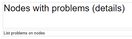

2. On the Layout Builder panel, write the title:

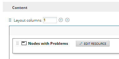

6. The Layout Builder view is displayed with the selected resource added. You can also modify the layout:

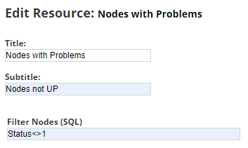

7. If you need to filter a resource to include a specific set of data, click Edit Resource.
8. Each resource has different filter options. Here's an example for Nodes that are not UP:
9. After adding and filtering the resource, click Submit.

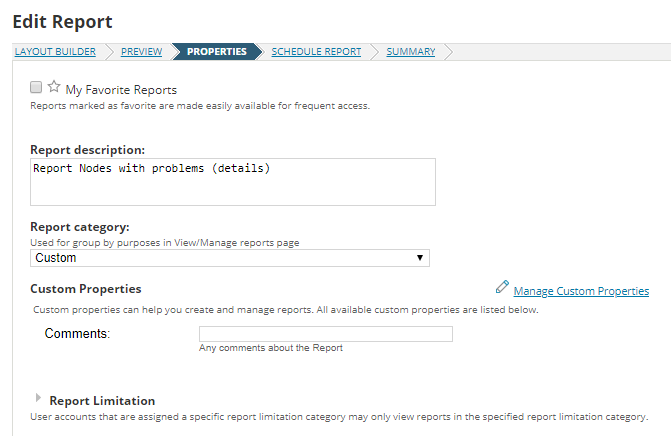

12. Add report properties, such as categories, custom properties or limitations and click Next:

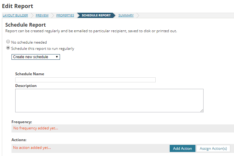

13. You can schedule a report to be generated, emailed, saved, or printed. To schedule the report, click "Schedule this report to run regularly"
14. Create a new schedule or assign a schedule and click Next:
