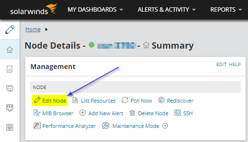

  1. Navigate to the Node Details page of the node in question by clicking on the node details hyperlink from almost any screen in NPM.
  2. Click on Edit Node

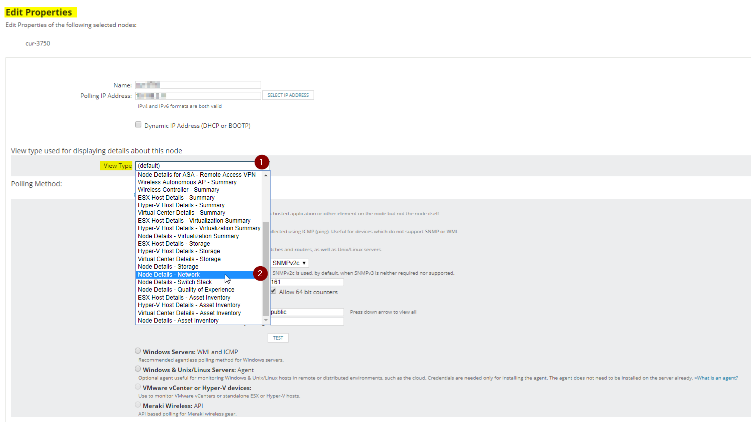

  3. On the Edit Properties page the first section after the Name and IP Address information is View type used for displaying details about this node. Click on the View Type dropdown menu where it say "(default)"
  4. Select the View Type you what to use
  5. Click on SUBMIT at the very bottom of the page
