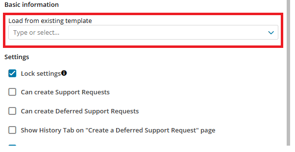

  4. Enter a name for the new Agent Configuration Template and select the Settings options to apply to the Agent Template:
  5. To use this created template, go to Devices.
  6. Edit a Device Group.
  7. Select the Template to use.
  8. Save Settings.
