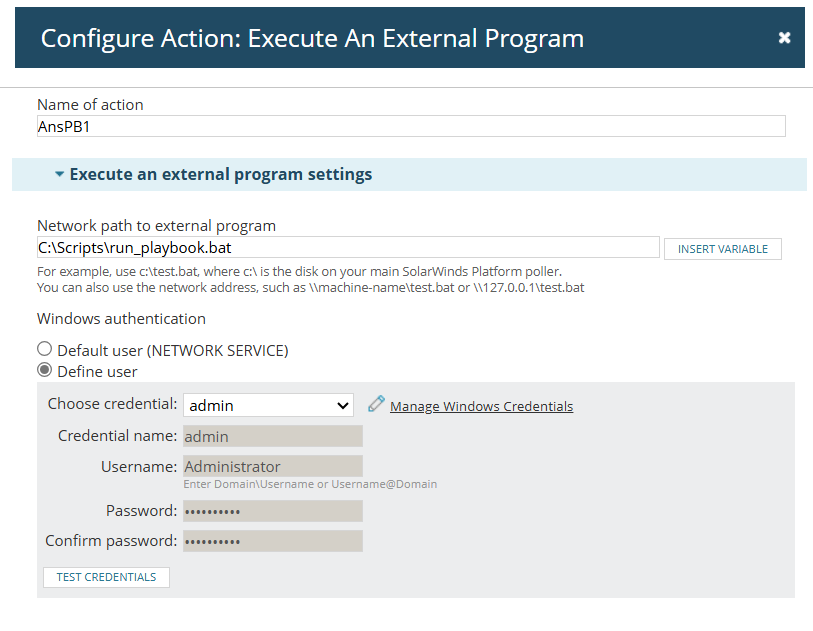

  • When editing or adding an alert, select Add Action in the Trigger or Reset Action section.
  • Choose Execute an External Program.
  • Configure the action to run the Windows script (e.g., C:\Scripts\run_playbook.bat).
  • Select the appropriate user account for running the script (preferably a low-privilege account tailored for this purpose).
  • Save and test the action using the Simulate button.
  • When the alert triggers, the SolarWinds Platform will execute the script, which remotely runs the Ansible playbook.

Configured Action:
