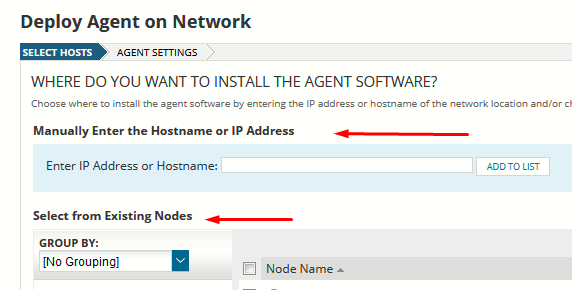

4. Select the deployment method, in this example we are going to use default i.e "Deploy the agent on my Network"
5. Enter the IP Address/ Hostname if you are adding a new node that is not already in the SolarWinds Platform and click add to list. Repeat the steps if you want to add more nodes OR Select From existing nodes already being monitored
6. Once you added/selected the nodes Click Next.

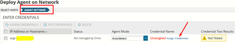

7. On Agent Settings Tab, you should assign credentials to each of the node if there are different or Select all the nodes and assign if the same credentials are used.

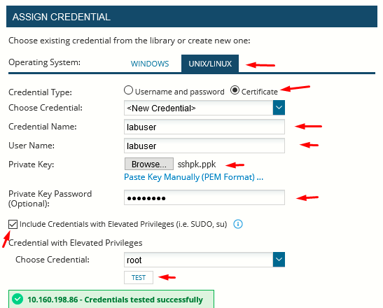

8. In this example there is only one node, so we are going to click Assign Credentials which brings us the following screen.
Note: In this example case, we are using an account that needs su previleges to authenticate and will be using the Private Key / Cert method.
a) Click on Unix/Linux Tab
b) Select Certificate Radio button
c) Enter Credential Name that is meaningful and fill in the User Name
d) Click Browse to select the Private Key OR Click Paste Key manually
e) Enter the pass phrase for the key if required (This is considered security best practice as Private keys should not be stored on computers without a pass phrase)
Note: If in your scenario if root accounts are used then don't need to Tick the Check box next to "Include Credentials with Elevated Privileges" - As we are using a non-root account here so will tick that option and enter root / super user credentials
f) Once happy, click on test
If all is well, you should see a message against each of the nodes in the list
g) Once you click on Assign you should see:
