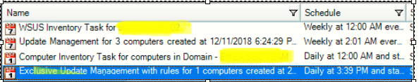

1. Log in to the Patch Manager MMC Console.
2. Expand Administration and Reporting ->  Scheduled Tasks -> In the center pane, select a scheduled task.
undefined
3. In the Information tab, locate the scheduled task ID. For example:
