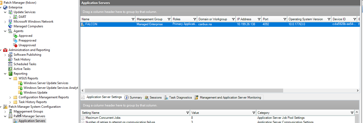

1. log in to Patch Manager and expand the Patch Manager System Configuration.
2 Expand Patch Manager Servers and click on the Application server.
3. highlight the Primary Patch server name and in the middle panel click on "Application server settings".

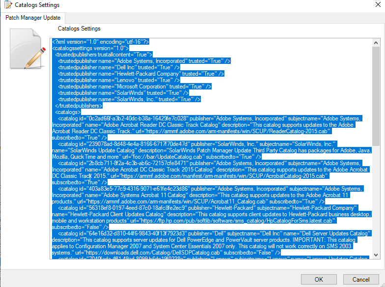

4. In the Setting Name field double click Catalogs Settings and delete

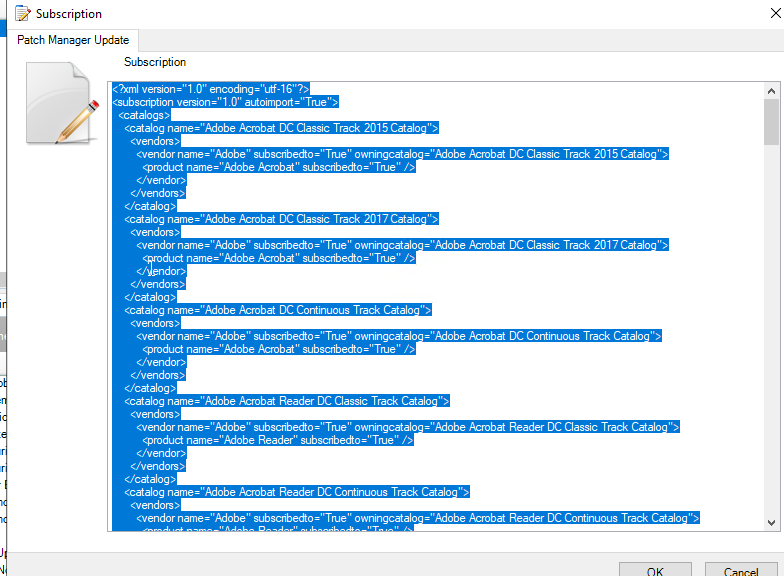

image.pngimage.png5. Double click Subscription and delete.

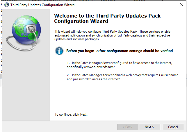

7. On the right action panel, click on Patch Manager Update Configuration Wizard. Run the wizard and bring in the Catalog.

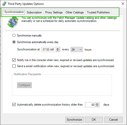

Be sure to go through all the tabs in the Third Party Updates Options that will appear after the first Synchronization is complete
