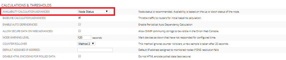

There is one other piece to this, which is how Orion calculates a node's availability over time. What’s the difference between status and availability? To keep it very simple, a node’s status is an indicator of what the node is doing now; a node’s availability is a measurement of that node’s status over time. Orion calculates availability in two possible ways: either by historical node status or by packet loss percentage over time. Orion includes the option of specifying which calculation to use. This setting is under Settings > All Settings > Polling Settings in the Web Console (screenshot below).
