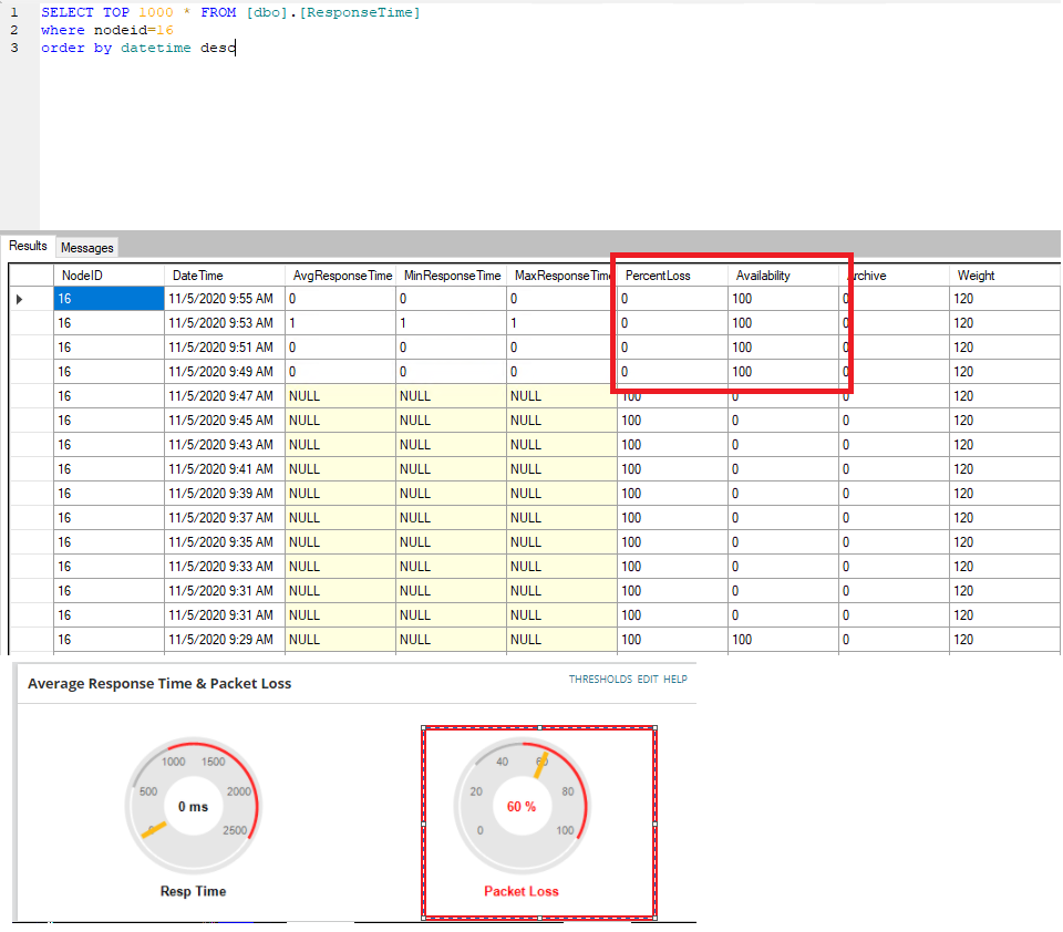

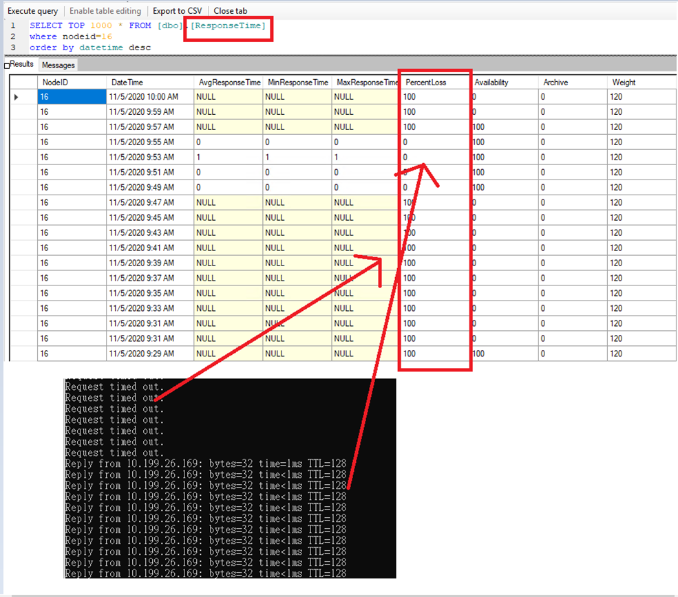

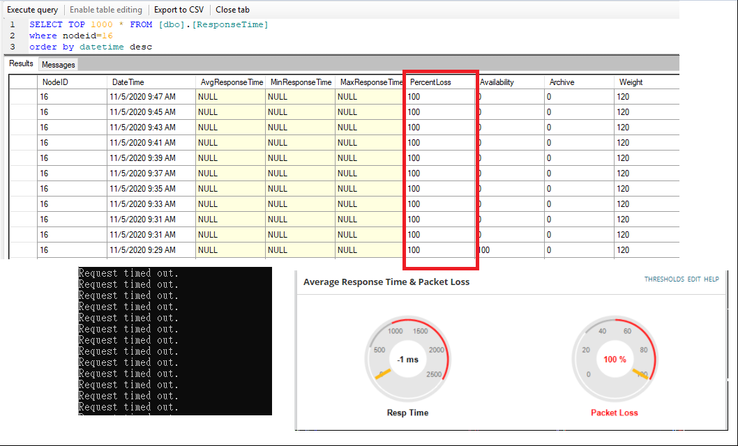

If the SolarWinds Platform is unable ping the node, and each single ICMP poll is recorded as 100 percentLoss in the responseTime table, the Packet Loss shows as 100%.

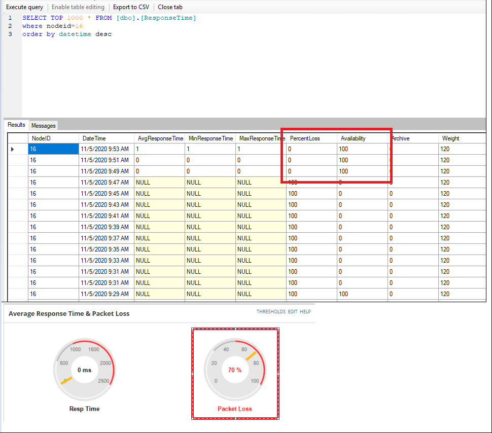

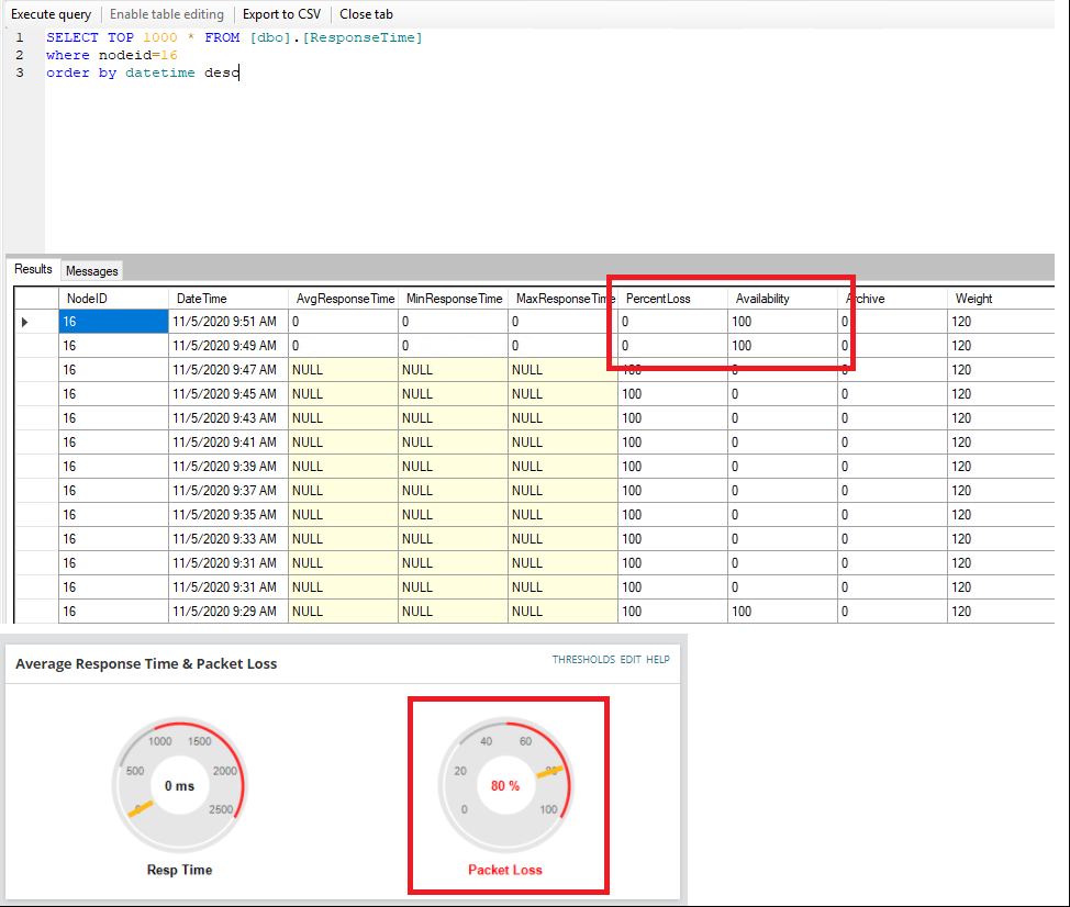

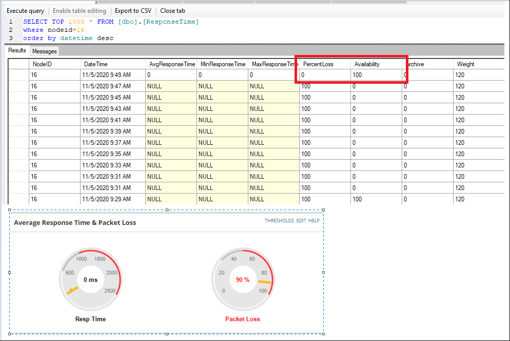

When the node is back online, from the first successful ping, the PercentLoss changes to 0, and the Packet Loss drops from 100% to 90%.
After every subsequent successful poll, the Packet Loss drops accordingly.
