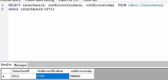

To verify SolarWinds is showing correct information, check from Interfaces Table & InterfaceErrorsView in the Database Manager on the SolarWinds server.

Calculations:
  •  Take value polled on first poll
  •  Then on Next Poll, compare the two, so you can see the difference
  •  e.g. If the first Poll was 140 and 2nd 160, discards would be 20
  •  Out_Discards = ifOutDiscards – prevOutDiscards
  •  OutDiscardsToday and OutDiscardsHour in interfaces table will be updated per every polling interval
  •  Repeat above for OutErrors, InDiscards, InErrors if needed
  • OutErrorsThisHour/OutErrorsToday, InDiscardsThisHour/InDiscardsToday, InErrorsThisHour/InErrorsToday, InDiscardsThisHour/InDiscardsToday will be reset accordingly
  • e.g
  • OutErrorsThisHour before 5pm shows 194563
  • It was being reset after 5pm, and then the figure showing the sum of Out_Errors after 5pm poll
