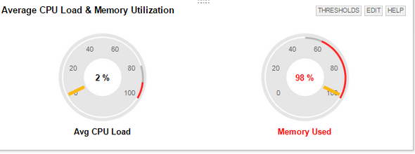

If the Average CPU Load and Memory utilization widgets display high memory utilization for Cisco Node with Network Performance Monitor (NPM) and Network Configuration Manager (NCM), verify that the correct memory poller is used.

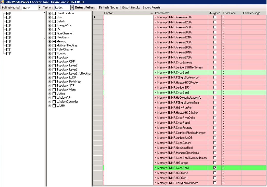

Assign N.Memory.SNMP.CiscoGen3 Poller using the Poller Checker Tool.
How to Use the Poller Checker Tool
  1. Navigate to C: > Program Files (x86) > SolarWinds > Orion > PollerCheckerTool.exe
  2. Run the executable.
  3. From the leftmost column, select the node to check the assigned/supported pollers.
  4. From the next column, select Memory of the related components.
  5. Click on detect pollers. Supported pollers are highlighted with a green background.

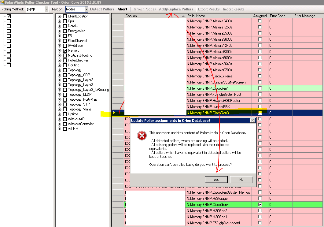

  6. Now select the N.Memory.SNMP.CiscoGen3 Poller and Click Add/Replace Poller.
  7. Click Yes.

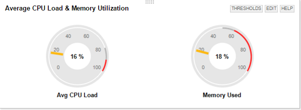

  8. Wait for 30 minutes and check the results.

  • For example, NodeID 539 has a Memory of 75% and it should be much less like 30%.
