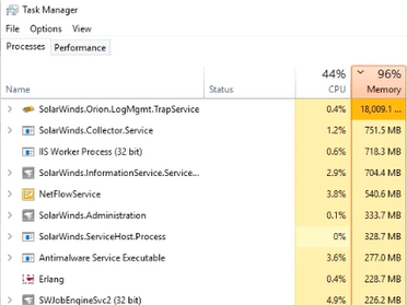

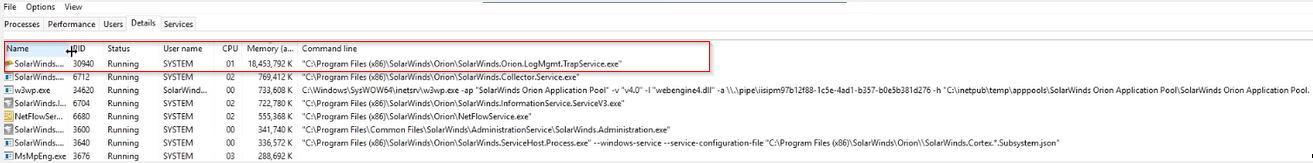

The article discusses an issue where the Polling Engine is experiencing High Memory Utilization where the SolarWinds Platform Log Trap Service is consuming it the most.
This article describes a workaround if the LogMgmt Trap Service is consuming the Top Memory Utilization in the Polling Engine due to Trap Service was unable to translate/decode Traps with very Long untranslatable OIDs
The problem is caused by long untranslatable OIDs which causes the Trap Service to consume memory in OID Translation.
Most of the SNMP Traps cannot be translated and the Trap service just ends up wasting time trying to find them in the database, thus slowing down the processing and increasing the consumed memory.

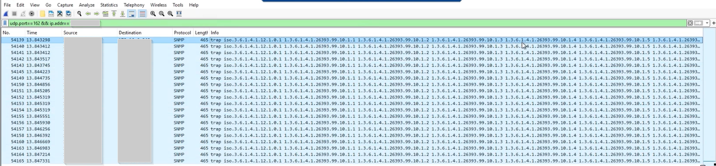

From the Wireshark Capture:

Configure the devices that send traps to the SolarWinds Platform to NOT use very long OIDs (for example: 3.6.1.4.1.12.1.0.1.1.3.6.1.4.1.26393.99.10.1.1.1.3.6.1.4.1.26393.99.10.1.2.1.3.6.1.4.1.26393.99.10.1.4.1.3.6.1.4.1.26393...).
