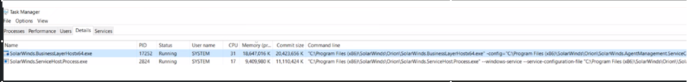

The polling engine is experiencing high CPU and Memory usage with both SolarWinds.BusinessLayerHostx64.exe and SolarWinds.ServiceHost.Process.exe processes. As a result, the web console and Agents may also be experiencing issues.
