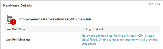

"Hardware polling failed: Polling of chassis (CIM_Chassis class) failed. Unable to establish session with all provided credentials." when polling for hardware health with VMware ESX / ESXi 8
This article provides information about an issue where hardware health polling data does not work and produces the error message of "Hardware polling failed: Polling of chassis (CIM_Chassis class) failed. Unable to establish session with all provided credentials."
Authorization of entities within the environment is crucial for securing the network against unauthorized access of the entities. Any attempt leads to a warning/error messages shown on the Hardware Details page such as “Hardware polling failed: Polling of chassis (CIM_Chassis class) failed. Unable to establish session with all provided credentials”.

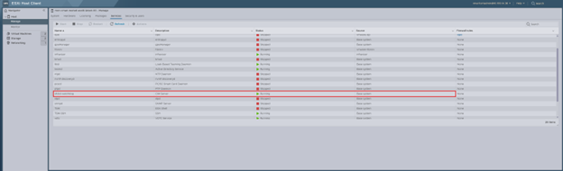

- Log in to the vSphere User Interface (using the browser and the IP address of the ESXi server)
- Go to Manage > Services.
- Scroll down until you see the "TSM-SSH" service on the list.
- Select the TSM-SSH service
- Click Start.
