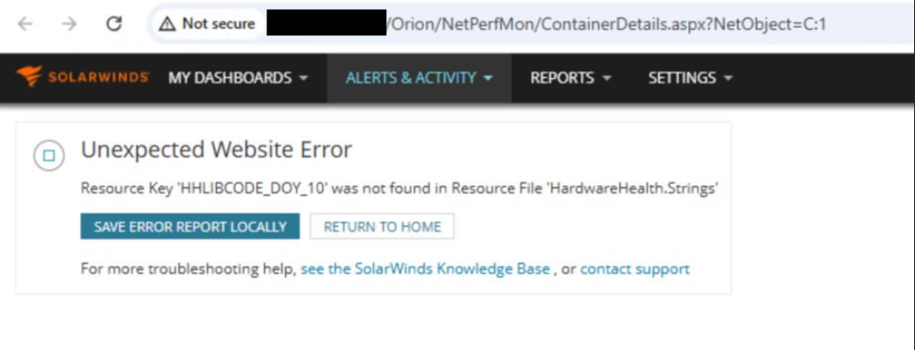

From the OrionWeb.log:
2026-07-06 14:22:25,525 [51] (16) ERROR ASP.global_asax - (null) Application_Error(c94d345bc4d94d809c46121e4413be86)
SolarWinds.Internationalization.Exceptions.TokenSubstException: Resource Key 'HHLIBCODE_DOY_10' was not found in Resource File 'HardwareHealth.Strings'
at SolarWinds.Internationalization.Tokens.TokenSubstitutionBase.WriteToken(Dictionary`2 values, IResourceStringRegistrar resMgr, TextWriter textOut)
at SolarWinds.Internationalization.Tokens.TokenSubstitutionBase.Parse(IResourceStringRegistrar resMgr, TokenSubstitutionSequence sequence, TextReader textIn, TextWriter textOut)
at SolarWinds.Internationalization.Tokens.TokenSubstitutionBase.Parse(IResourceStringRegistrar resMgr, TokenSubstitutionSequence sequence, String textIn)
at Orion_HardwareHealth_Resources_Hardware_HardwareHealthForGroup.Render(HtmlTextWriter writer)
Orion Platform
The Hardware Health Chart is trying to load a display label that is missing. When that label cannot be found, the Group Details page will fail to load.
This does not mean the monitored device is down. It also does not mean all Hardware Health polling has stopped. The issue is limited to displaying the Hardware Health Chart on the affected Group Details page.

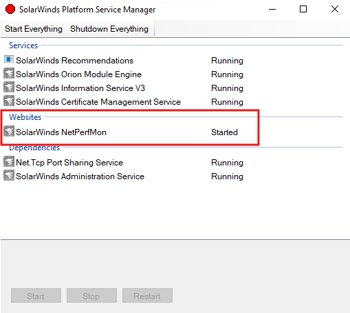

On the SolarWinds Server using the SolarWinds Service Manager, restart the SolarWinds NetPerfMon website.

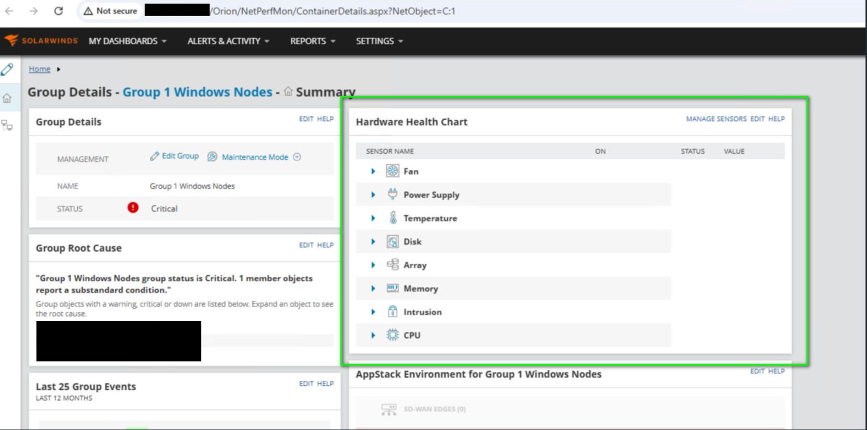

Refresh the Group Details page, and it should now load:
