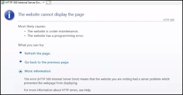

While opening the login page for the Orion website you may be presented with HTTP 500 Internal Server Error:
(Screenshot property of © 2022 Microsoft)
